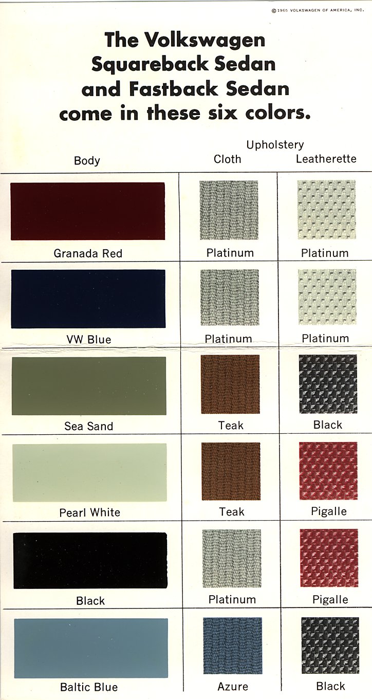

"ripsteak" is the interior (upholstery) color. See brochure here:
Since your car is a "late 66" I believe it does NOT have the brown dashboard, and NOT the brown steering wheel (both is black on your car), so it's a "normal" 1966 Variant as many others.

Anyway your pics are really usefull... I love the sea send color and will be a pleasure to make it in mine... but I'm still in doubt about the interior color,
are you telling me the color of my car's interior should be Teak? So if you bought a sea send square/nocht the only coupling available were the teak?

If the outside color is sea sand L568 you had 2 options for the interior:
a) cloth interior: "ripsteak" (code 51) = brown (see brochure above)
b) leatherette interior: "black" (code 80) = black (see brochure above)
That's all there was available.
